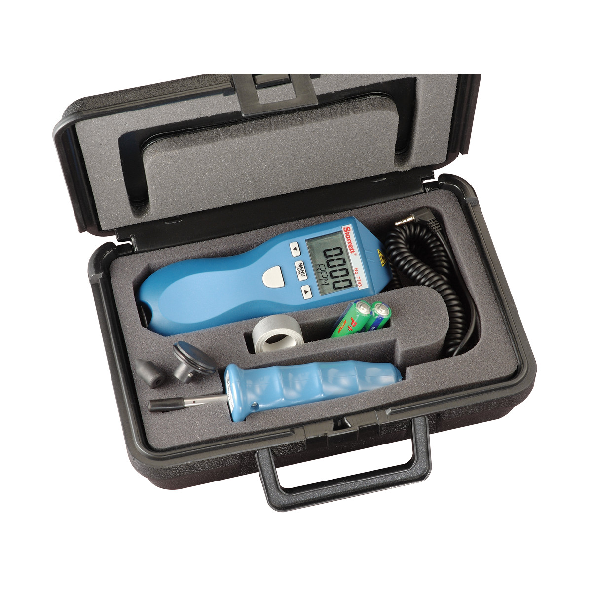

Pocket Laser Tachometer Kit with Case
68930

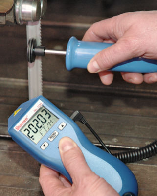

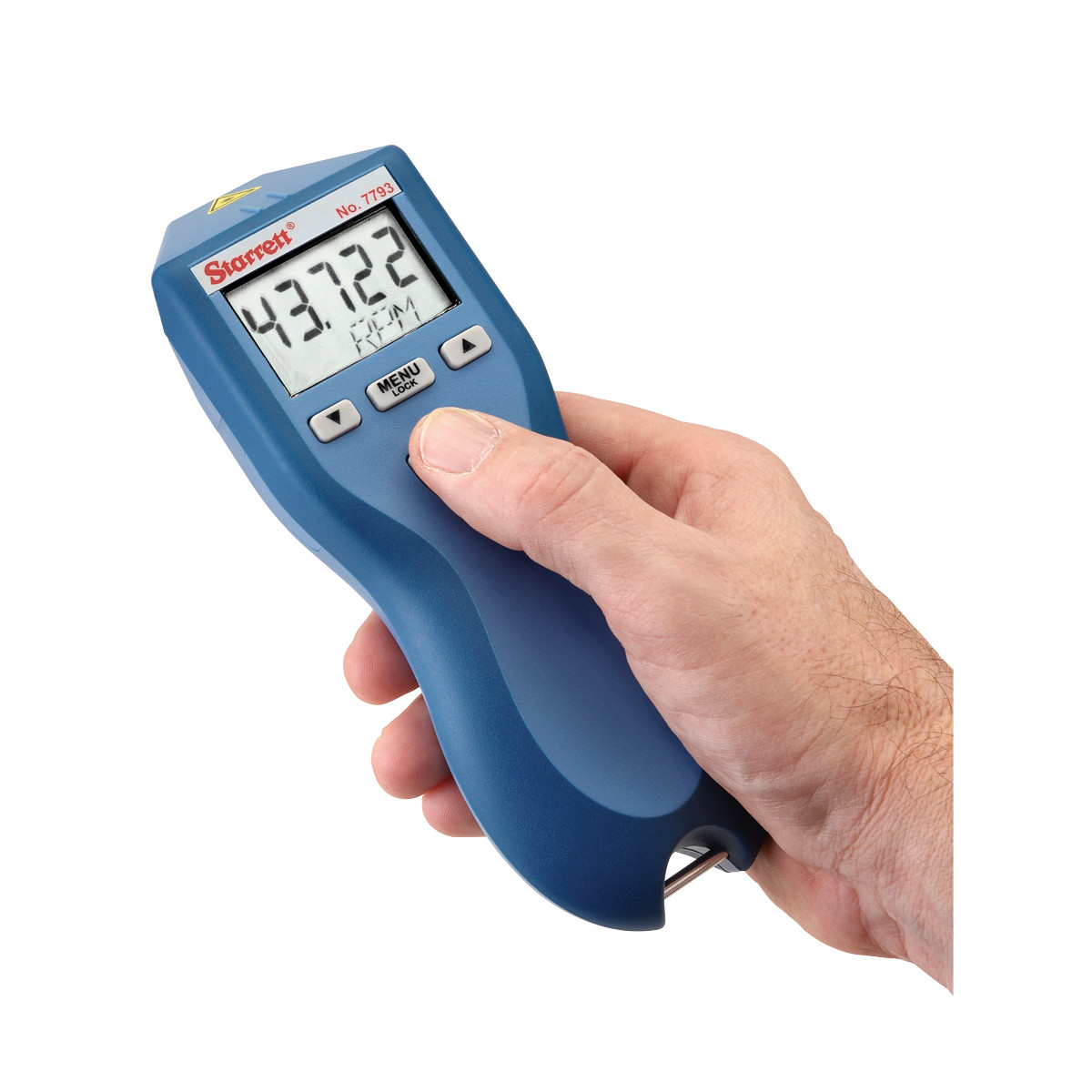

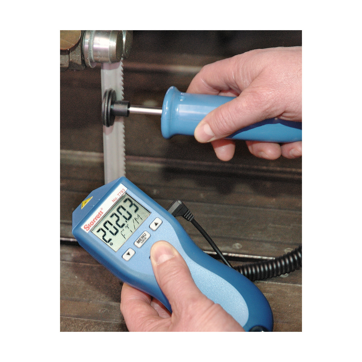

The Pocket Laser Tachometer is a digital, battery-powered portable optical tachometer that can operate up to 25 feet from a reflective target using a laser light source.
Powerful 32 function Tachometer/Ratemeter, Totalizer/Counter and Timer
Programmable in both inch and metric rates
TTL compatible pulse output to trigger devices such as data collectors or strobocopes
Ergonomic design makes measurement of speed and RPM simple
Kit includes Tachometer, RCA, contact tips,10cm linear contact wheel, 59 of T-5 reflective tape, (2) AA batteries, carrying case
