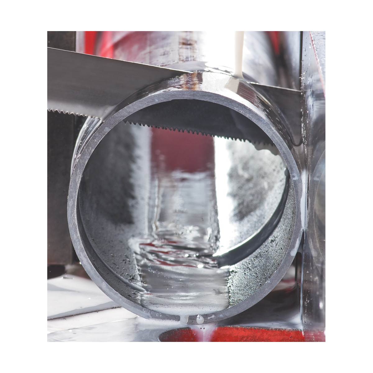

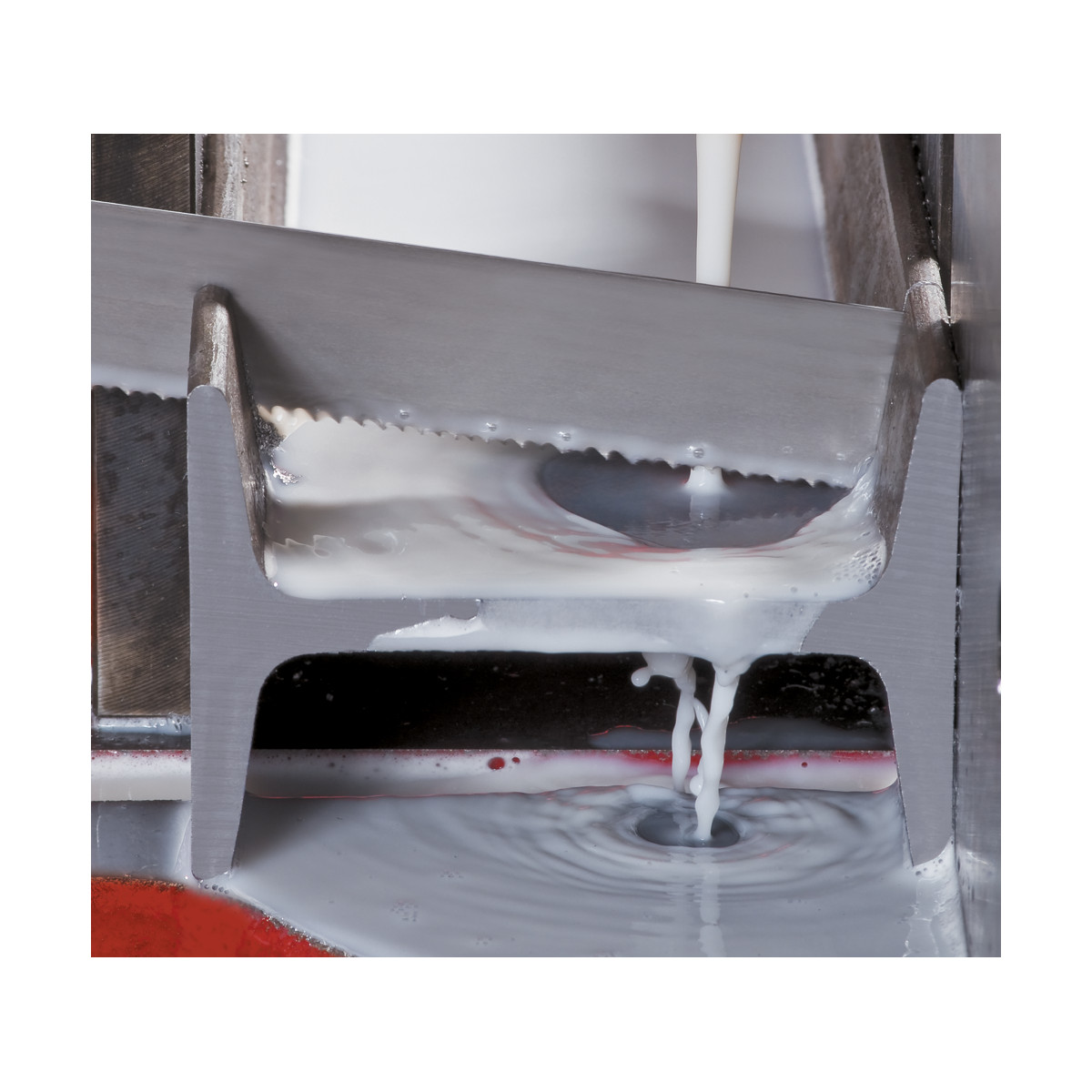

Versatix MP is a bi-metal blade of triple-tempered, high-speed M-42 cobalt steel teeth with alloy steel backing strip. It has a patented tooth design that dissipates stress during cutting for less tooth breakage and longer blade life. Its special set minimizes pinching when cutting structurals and bundles. They are ideal for sawing structurals, tubes and small solids and pull-down, gravity fed machines with uncontrolled feed rates.
New tooth design for increased tooth strength and reduction in tooth strippage associated with intermittent cutting and uncontrolled feed rates
Triple tempered M-42 cobalt high speed steel teeth combined with a fatigue resistant alloy steel backing strip
Special set for extra blade clearance minimizes blade binding or pinching when beam stresses are relieved and/or when bundles move during cutting
