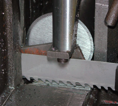

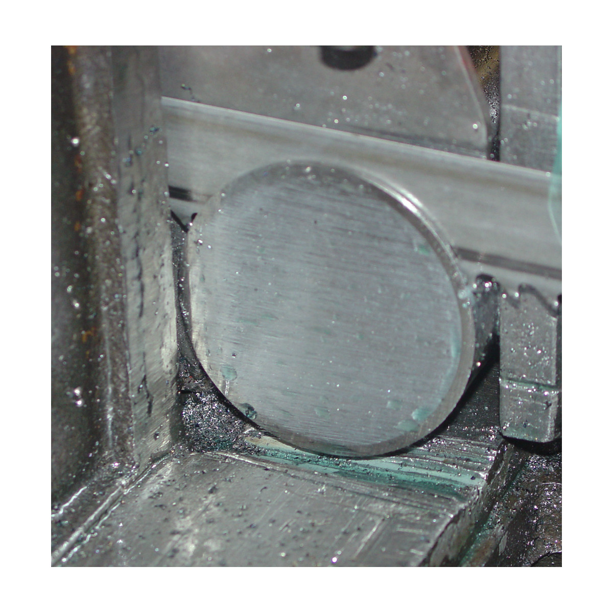

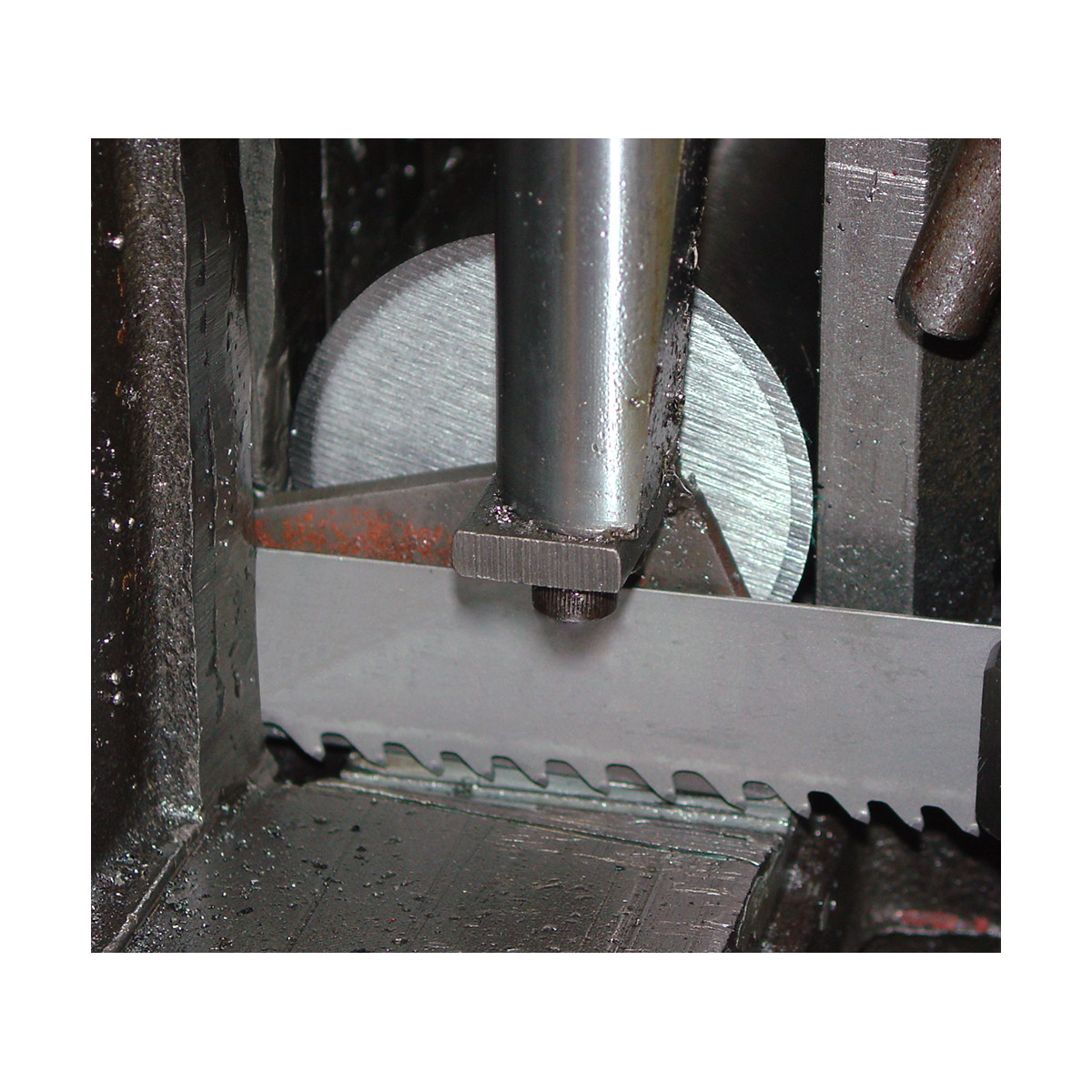

Advanz CS Band Saw Blades
Advanz CS is a carbide tipped blade with teeth ground from high quality micro-grained carbide cylinders welded to a tough, ductile backing material. They have a 20º negative tooth tip rake angle for increased strength to penetrate high hardness materials while providing resistance to fatigue, shock and wear. They are ideal for cutting induction hardened chrome shafts, linear bearing shafts and case hardened materials to HRc 65.
New carbide tipped band saw blades designed for cutting cased steel and induction hardened chrome shafts.
Teeth ground from high quality micro-grained carbide cylinders welded to a tough, ductile backing material.
20° negative tooth tip rake angle for increased strength needed to penetrate high hardness materials.
Triple chip tooth geometry.
Exceptional resistance to fatigue, shock and wear.
Ideal for shafts, induction hardened shafts, linear bearing shafts and case hardened materials up to HRc 65.
