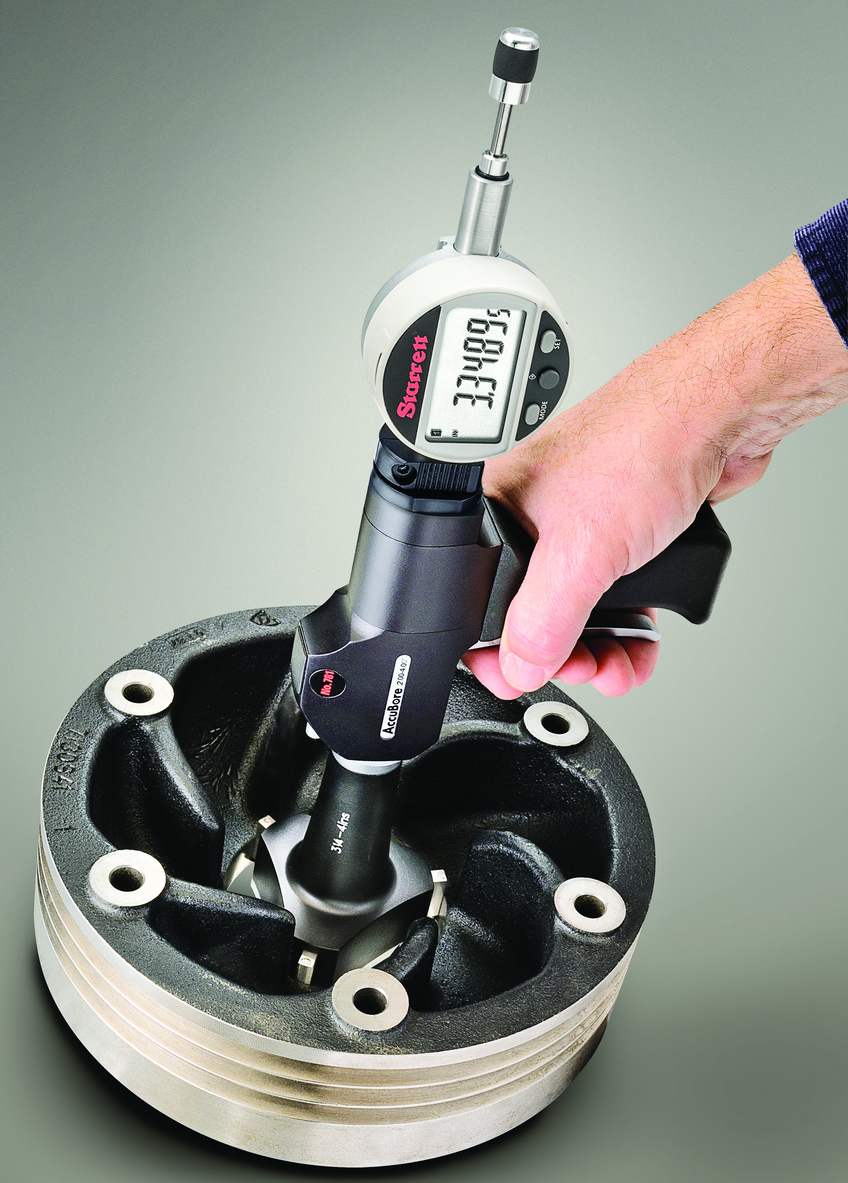

Prevent Out-of-Roundness
When machining bores, challenges with fit and out-of-roundness may result in lobing. Out-of-roundness can be caused by centerless grinding (5-lobing), a worn or out-of-balance spindle (irregular-lobing), workholding with a three jaw chuck (3-lobing), and other sources. In an internal roundness scenario, lobing often occurs when applied forces on a limited wall thickness surpasses the material’s yield limits. The result impacts the roundness of the internal diameter.
Conversely, external roundness can be impacted when machining a material where its strength is inconsistent through the workpiece (coatings, for example). Out-of-roundness can be uncovered by irregular travel of an indicator or parts not fitting properly. Out-of-roundness is either asymmetrical (irregular lobing) or symmetrical (regular lobing). Empirically discovering that the fit is incorrect can be too late and very costly to rework
Selecting the most appropriate bore gage will significantly minimize these challenges.  Sometimes, roundness geometries are important enough to have metrology equipment specially designed to measure it. This is a costly, but very effective way to profile the specific roundness of a part. If the parameters can be established for the finished part, specific operations can then be monitored in-line with a bore gage. This can reduce the expertise required, empower operators, and improve the end results of the finished parts.
Roundness or ovality (a basic subset of roundness) is typically not specified, however. But understanding the character of an internal diameter can build confidence when qualifying your work. An effective internal diameter requirement with an overall tolerance is more typical. Bore gages can improve confidence as opposed to using a slide caliper or other two-point instrument. The benefits include greater resolution, accessibility to depth, and ease-of-use.

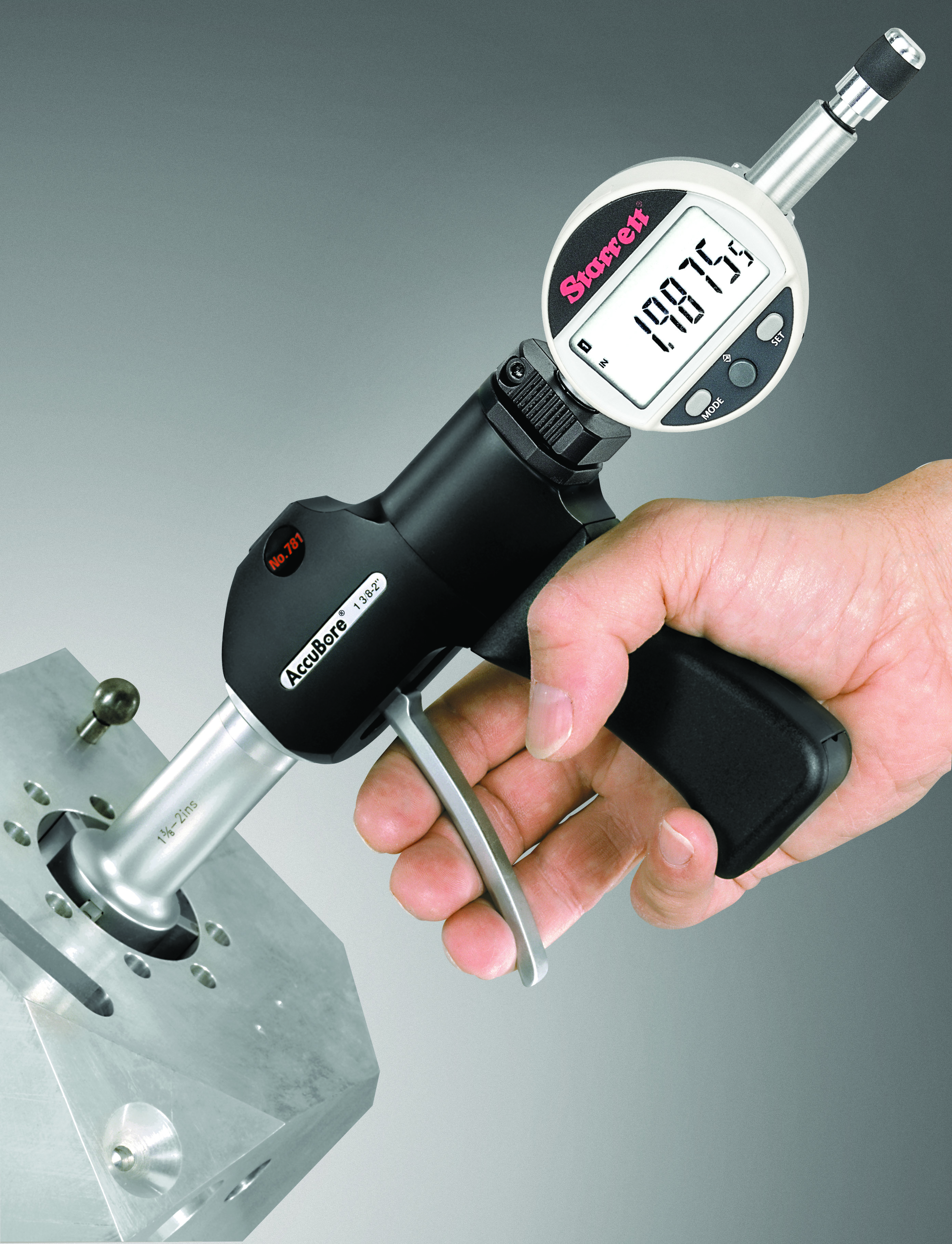

Whether to use a two-point or three-point contact measuring tool is an important decision since there are some differences. A two-point contact rod-type inside micrometer is usually lighter, easier to handle and more versatile over long ranged from approximately 6"-107" (150mm - 2700mm). Compared to a three-point contact, any two-point contact micrometer, regardless of range, can probe a hole better to find the geometry of that hole.
Most three-point contact tools have setting rings to ensure accuracy. If the goal is very close tolerance work with two-point contact inside micrometers, it is recommended that they be set to a ring gage or to an outside micrometer.
A three-point contact micrometer has an advantage in that it can be seated in position more quickly than a two-point contact tool. The three-point tool will tell the maximum true diameter that can enter the hole a little faster than a two-point contact tool. The measuring heads used in these tools are accurate to ±.0001" or 0.002mm, but overall accuracy on tools all measurement equipment is dependent on good practice and technique.

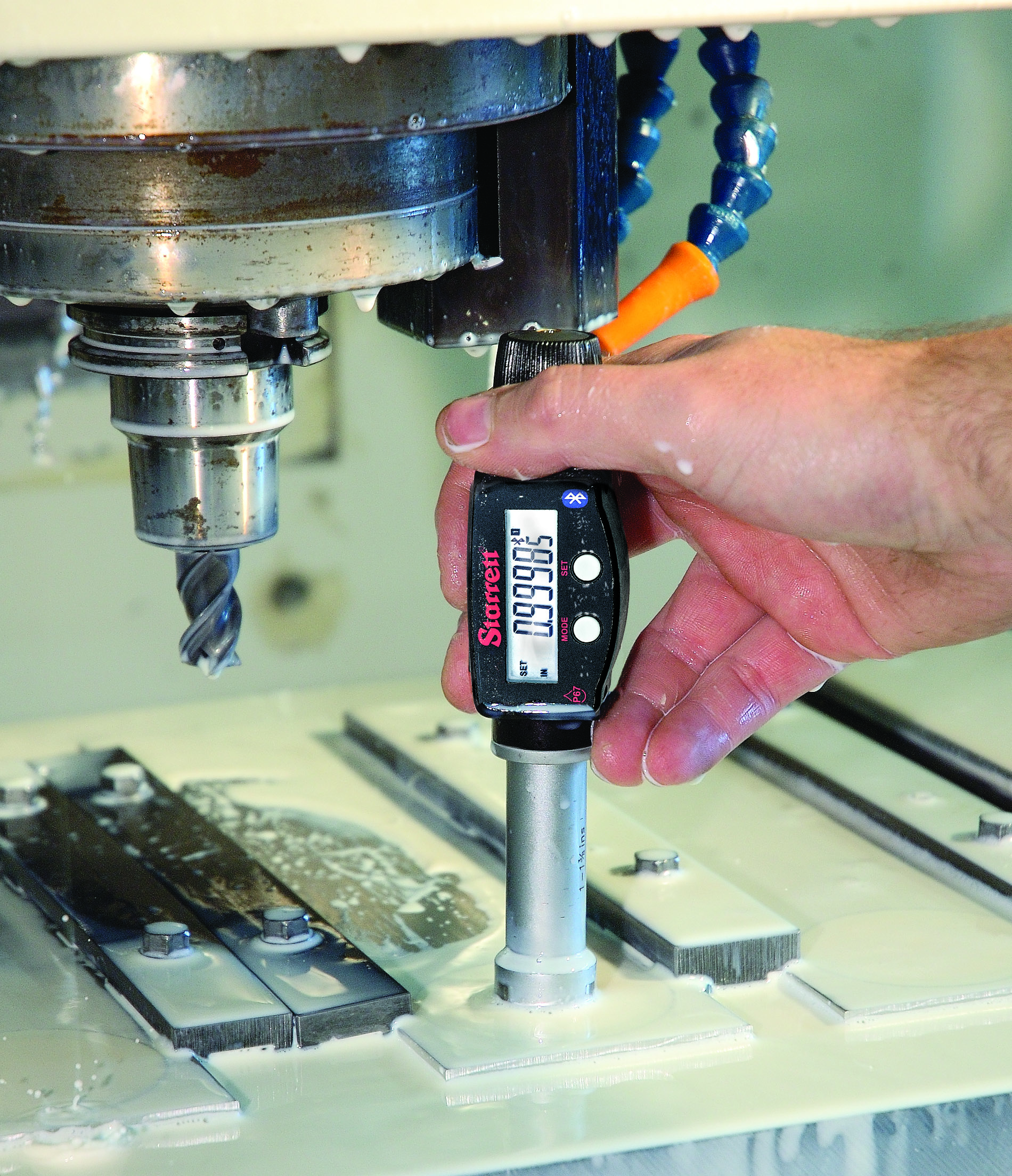

Setting Up a Wireless Bore Gage
  1. Determine the bore (hole) sizes that you are going to need. Software and other equipment are included in with the purchase of a gage.
  2. If you plan to connect multiple gages to a single PC, then purchase software (a physical software USB key). You will need to use this USB key to install the software and unlock the multiple USB dongles. Each USB dongle will connect up to 8 tools. So if you’re connecting more than 8 tools, you will need more than 1 USB dongle connected. An example would be the following:
    • If you need to connect 10 gages, you will need three USBs inserted: 1) The Software USB Key; 2) A USB dongle for the first 8 tools; and 3) A USB Dongle for the remaining 2 tools].
    • Within the bluetooth (“bt”) submenu on the gage, go through these three steps:
      1. Go to “bt” OFF, and SET to OFF.
      2. Go to “bt” RESET, and SET to RESET.
      3. Go to “bt” ON, and SET to ON.
  3. Install the software and then connect the required number of USBs.
  4. Prepare each tool to be paired. Here’s how:
  5. Pair the tool by selecting “BT Scan” button on the main software screen. Wait for the device(s) to pair.
  6. The devices should now be active, green, and displaying on the software the precise reading on the gage.
