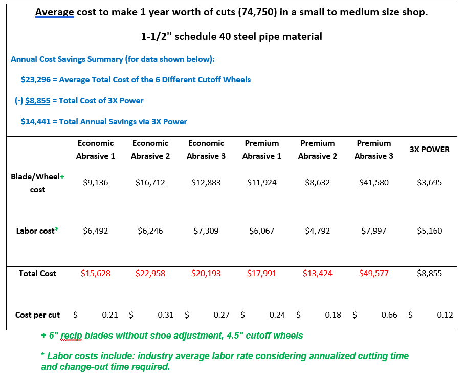

See Chart 1 (below) - Performance cutting tests conducted at Starrett comparing 6" 3X Recip blades to 4.5" abrasive cutoff wheels yielded an average annual savings advantage of over $14,000 when making 74,750 cuts in schedule 40 steel pipe, as compared with using a variety of cutoff wheels for the same application. This example is based on what a small or mid-sized shop may see and assumes 3 operators at the national average labor rate* using 1 box of abrasives (25 wheels in each box) per week each for a total of 75 wheels weekly versus 6 recips per operator each week totaling 18 blades for the same weekly time period.
