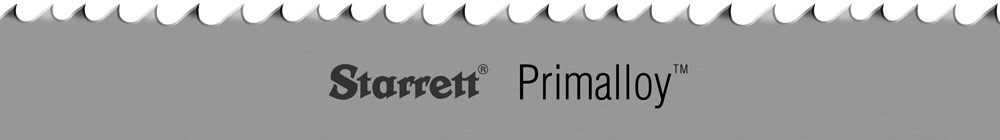

PRIMALLOY™
The Prime Bi-Metal Band Saw Blade for cutting edge performance.
Shop Primalloy™
Primalloy™ band saw blades are designed for heavy-duty cutting applications. The cutting performance of the high-speed steel is greatly increased through alloying with cobalt and vanadium. These alloying elements substantially increase the heat resistance as well as the wear resistance. The Primalloy Saw provides superiority in overall wear and operating life without the expense of carbide-tip solutions. With Primalloy edge and Extended Life Treatment (EXT) functionality, the Primalloy Band Saw minimizes blade replacement thus cutting costs resulting in steadier production.

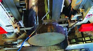

Applications:
- Tool steel and high-speed steel
- Stainless steels
- Nickel and titanium alloys
- Hardened steel
- For machines with hydraulic feed control
