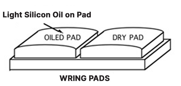

  2. Wipe the surface of the Optical Flat gently across an oiled Wring Pad.
  3. Wipe the surface of the flat gently across the dry pad.
