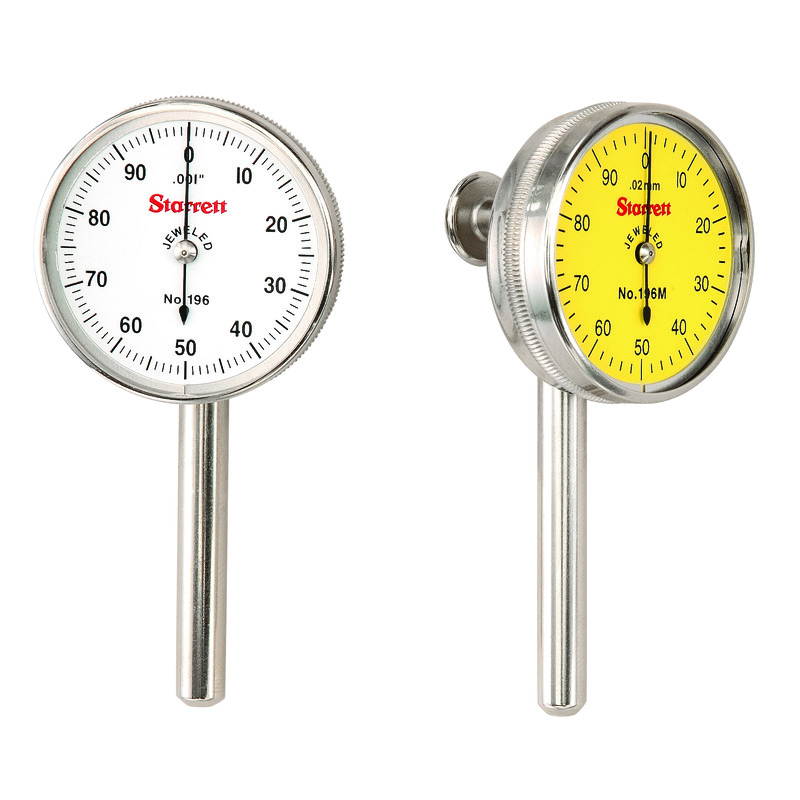

196, 196M Universal Back Plunger Dial Indicators
Our 196 Indicator is one of the most versatile indicators available … and it is the "granddaddy" of them all. Over the years this tool has been improved by methods and materials, but the basic design is unchanged. The design has withstood the test of time and beaten all challengers because it is:
  • Accurate and reliable
  • Simple to operate
  • Rugged, with few moving parts
  • Smooth in operation
