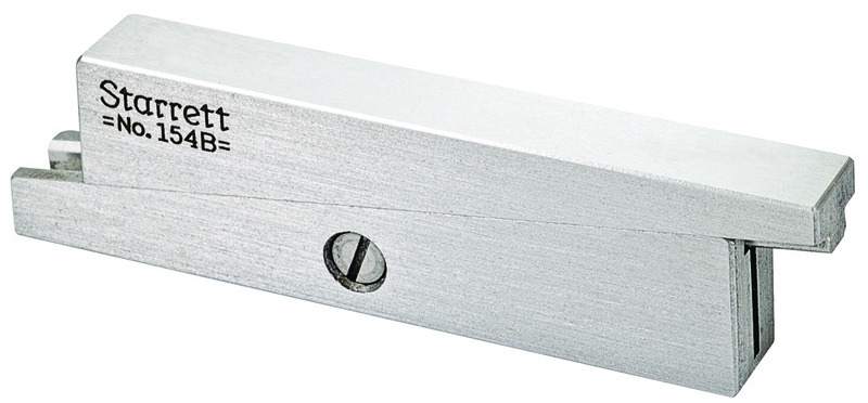

Adjustable parallels are high grade steel blocks with precision ground parallel edges used for activities like precision spacing, transfer dimensioning, and fixed Go-No Go gaging.
154 Adjustable Parallels - 3/8 – 2-1/4"/9.5-57MM
These adjustable parallels provide a wide range of use in layout, gaging, inspection work and for setups on various machine tools. Their adjustablity makes it possible to adjust them to exact size by micrometer measurement and also permits use in place of several solid-type parallels. These parallels are useful as gages in checking the size of slots and openings. They are also convenient for use in machine vises, for leveling or adjusting work on setups of milling and grinding machines, shapers, planers, drill presses and for many other applications. Parallels slide smoothly and can be easily adjusted. The smaller sizes A, B, and C, are locked by one screw while the larger sizes, D, E, and F, have two lock
screws. All parallels are 9/32" (7mm) thick.
