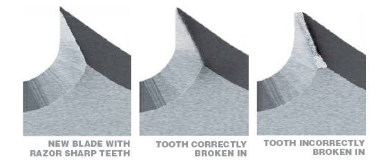

What does breaking-in a blade actually do? New band saw blades have very sharp edges on the teeth. That very sharp edge is easily broken and chipped if not broken in properly. Just like a very sharp pencil, the sharp point can break off when you start using it, leaving an irregular, jagged point that doesn’t write well. By gradually increasing the feed pressure during break-in, the sharp tooth edge is evenly honed, leaving a very fine radius to the leading edge of the tooth. This radius allows the chip to shear away from the workpiece more readily, and also gives the required support to the tooth tip, which undergoes extreme forces in the cutting process.

The process to break-in a band saw blade will vary depending on the characteristics of the material being cut. While breaking-in a blade, have the machine running at the normal surface feet per minute (SFPM).
For softer materials, such as carbon steel and aluminum, adjust the feed pressure to 50% of the normal cutting rate for the first 50-100 square inches. Then, gradually increase the feed pressure to 100% cutting rate.
For harder materials, such as nickel-based alloys including Inconel, or other difficult materials such as hardened steels, tool steels and stainless steels, adjust the feed pressure to 75% of the normal cutting rate for 25-75 square inches. Gradually increase the cutting rate to reach 100% after 50 square inches. As the feed pressure is increased to the 100% cutting rate, be careful to avoid creating vibrations that can occur by increasing the rate too quickly.

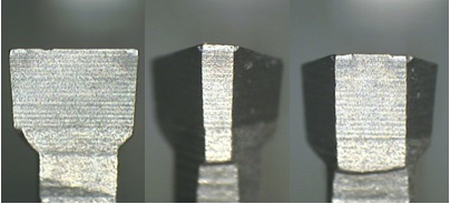

Below are examples of damage to a tooth’s cutting edge that can happen when the proper break-in process is not followed.  The photos show Carbide Tipped band saw blades. The blade was run at full speed and with full feed pressure on its initial cut. It is easy to see how the sharp edges of the teeth have been unevenly chipped off.

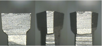

  The following three photos show how with a proper break-in, tooth edge damage can be avoided.
Once the teeth are honed and properly broken in, the blade will cut faster, straighter and last longer than an incorrectly broken-in blade. Following a proper break-in process is a simple, easy way to ensure that you’re getting the maximum productivity in your sawing operation.
