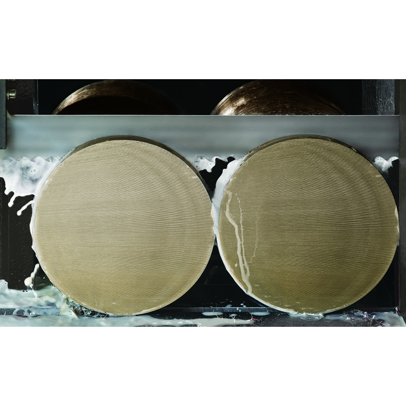

The Advanz™ MC5 delivers fast, precise cutting and an excellent surface finish. The Advanz™ MC5 utilizes a multiple chip grind with a high/low tooth sequence. The chip load is spread out over more teeth to facilitate longer life.

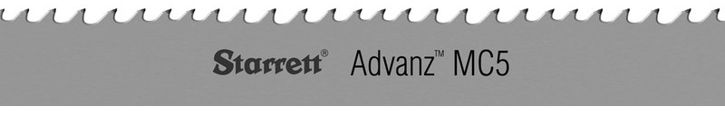

  • Exclusive Starrett tooth geometry
  • Carbide tipped
  • Ground tooth produces 5 chips
  • Utilizes a multiple chip grind with a high/low tooth sequence
  • Positive rake angle
  • Sub micron carbide (HV1600)
