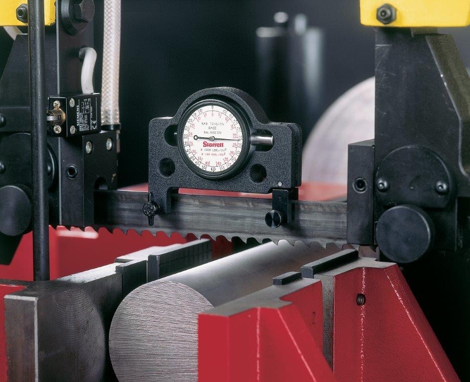

Starrett Saw Tension Gage
Also, low blade tension will “bow” the blade as it travels between the guide arms, causing cracking in the back of the blade. You can easily check this with a tension gage. You may look at reducing feed rate or pressure to avoid wear on the back edge of the blades and other issues.

The blade may also not be supported properly, so adjusting or tightening the guide arms will be necessary when you install a new blade. Low blade tension may be another factor because it allows the blade to “walk” in the cut. Tension should always be set to the machine manufacturer’s recommendations and a blade tension gauge should always be used. And be sure you are using the correct tooth pitch. As with incorrect feed and speed, an incorrect tooth pitch can cause chip packing in the gullets, which will lead to stripped teeth.

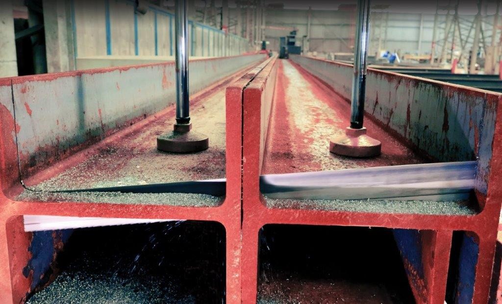

Unlike solid rounds and billets, the interrupted nature of sawing structural materials causes additional challenges that can increase blade wear and tear. In almost all structural cutting, the blade is engaged in the cut for a shorter period of time compared to the overall size of the material. This can subject the blade to increased force and vibration as the teeth move in and out of the workpiece material. Also, when bundle cutting structural material shapes, the possibility of material moving while being cut can increase dramatically, depending on which material is being bundled. For instance, round material tends to spin, which leads to premature blade dulling and increased potential for teeth stripping. Holding material tightly is a must, because any movement in bundled material or a single bar will cause tooth breakage. Tighten vises or use nesting clamps for best results.

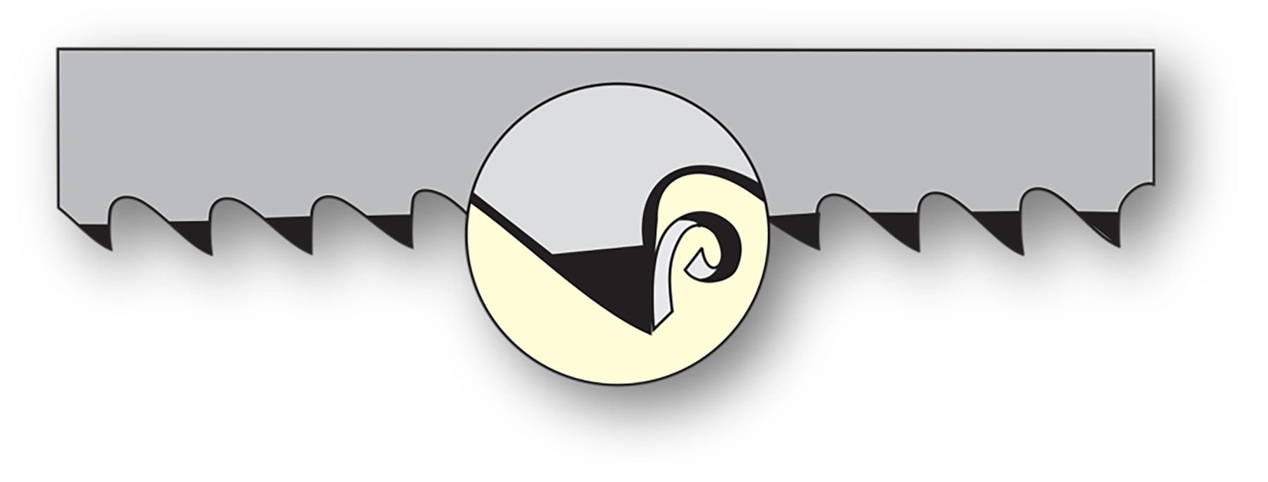

Chip Welding illustration
• Chip Welding – Chips loading up on the saw blade gullets can negatively affect the quality of the cut. Keep an eye out for a worn, mis-adjusted or missing chip brush. If a brush is not installed correctly or is inoperative, it can allow chips to load up in the gullets which can increase heat and lead to chip welding and stripping. Also check for improper or lack of coolant, and excessive feed or speed which could cause chip welding due to heat buildup.
